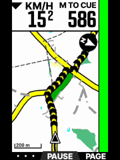

I sometimes notice that the combination of OSM/cycle.travel/my Wahoo Elemnt Bolt v2 doesn't handle parts of routes correctly but I don't know which is to blame!
I will give examples like this as I notice them.
Fortunately, I am familiar with the roads below because there was no cue at the crossroads at 1 km so I would not have had a clue which way to turn. I was just told at the start of the lane that the next cue was in 3 km time, which was after passing through the next village. I did not have priority at the crossroads - white lines to cross so I couldn't just follow the direction of the road. It probably isn't relevant (?) but the road opposite is no-through.

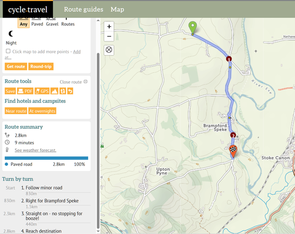

Honestly - it wouldn't! Here are 2 examples that I knocked up...
You could just ignore the selector box altogether and the software would just do what it does now!
Here though, I would have used the selector to force the point to a RightTurn type so my Wahoo would respond correctly.

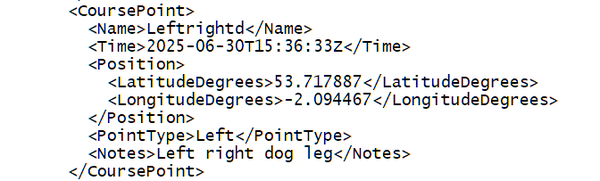

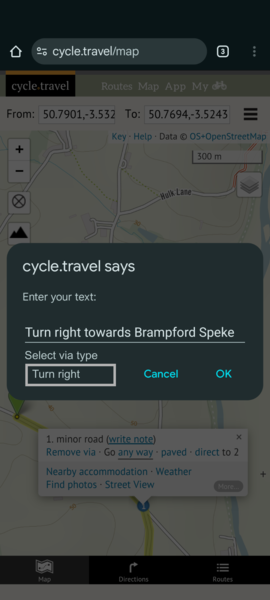

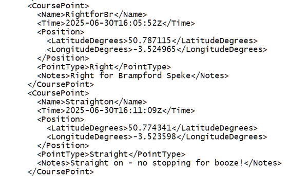

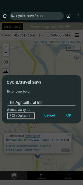

Unfortunately a waypoint selector dropdown isn’t really a goer – partly due to the amount of work in itself (it would mean coding an all-new dialogue box for entering details, there’s no way to add it to the existing one), and partly because the via point handling on the backend needs a comprehensive rework anyway so I don’t really want to make it still more complex by bolting more things on.
I have however just tweaked it so that if you include the word ‘left’, ‘right’ or ‘straight’ in your via point text, it’ll spot that and use the appropriate icon in either a TCX course or GPX route.

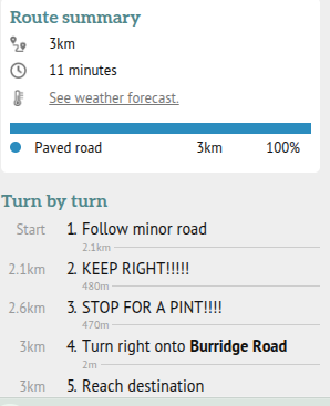

The notes feature was almost perfect, and @Richard has solved my problem overnight - excellent. Thanks Richard - who needs a silly point type selector box ;-)!
Here is an example dealing with the dog leg junction that I mentioned elsewhere yesterday...
And the via course point generated in the TCX file...
And here is the original problem handled, together with a warning about the village pub!
