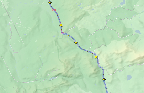

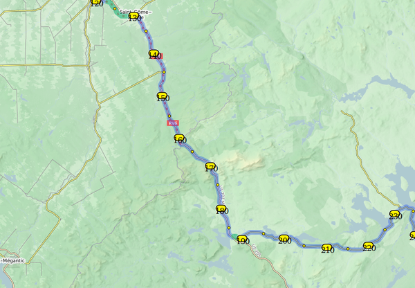

Your sarcasm is not necessary. Maybe my description of the issue is not clear, so I'll add some images showing the issue (using your journey).
Zoomed out, it's ok (border appears at about km 160):
but when I zoom in, the border (shown as a line) completely disappear:
so when creating a journey going close to the border, I keep having to zoom in/zoom out (to ensure I'm not crossing the border accidentally) which is tedious.

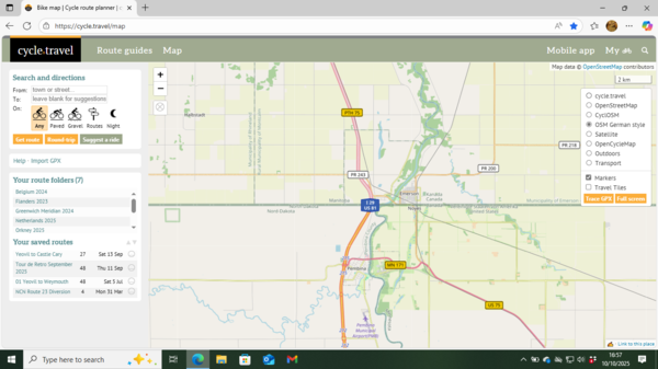

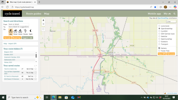

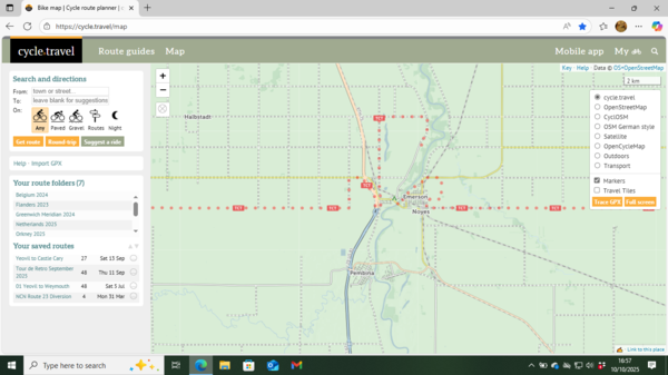

As a possible help, you might try toggling from the cycle.travel base map to OpenStreetMap or OSM German Style, both of which seem to show borders more distinctly. These are accessed via the map layer icon (a stack of diamond shapes) near the top right of the screen.
As an example, the North Dakota-Manitoba border appears as this on the default C.T map. The line of red dots hugging the border is the Trans Canada Trail, but the border line is invisible.
Selecting OpenStreetMap gives you this:
And OSM German Style gives this, again with a clear border:
