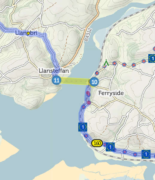

I've done a route in south wales and want to use the Llansteffan to Ferryside Ferry (having checked the tides!).  But i can't manage to persuade the system to not take me via Carmarthen ....  I could of course split the route into two journeys, before and after ferries but ....

Ann, I'm a bit confused by your route. First things first, you have a viapoint placed in Camarthen so CT will route you through there.

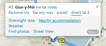

You seem to be using the 'direct to' feature bit I'm not sure it's correct. My suggestion would be to place a viapoint on each side of the ferry crossing, say VP 1 & VP2. The using 'Direct to' connect VP1 to Vp2.
That should simplify things.
I think that what is happening is that the ferry is not showing up in OSM and therefore CT isn't using it. It's being conservative and as someone who cheerfully pulled up to a Dutch ferry crossing only to find that the next ferry was in about 3 months I tend to agree with such an approach :-)
  Here is a quick edit of your route using the ferry and ignoring Camarthen:
https://cycle.travel/map/journey/778306

My trip is too far away to think about timings, but I plotted a “direct to” link as HobbesOnTour suggests.
