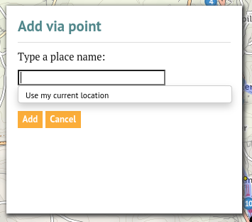

Hi, I am relatively new to cycle.travel, but find it very useful and interesting.  Could you clarify if there is a limit to the number of viapoints which can be included in a route?  I've clicked the box to add them, but it seems to stop after the 20th viapoint.  This has been using the web site in both Google Chrome and Edge.

Could you explain how you are adding viapoints? For example, I just click on the map whereas there is an option to add them via a 'box'.
