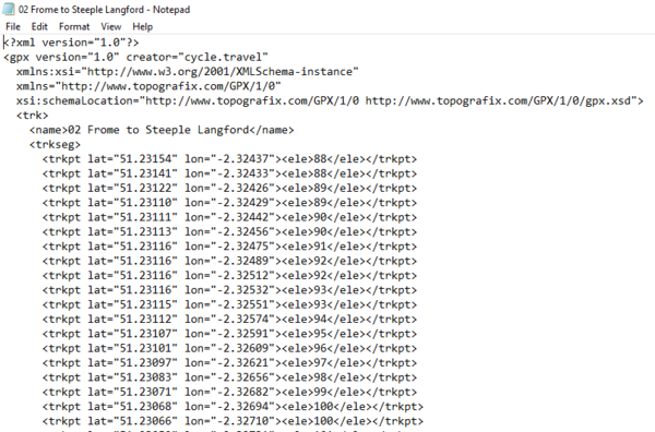

The GPX file generated by cycle.travel is for a route you are planning to do. As such, it does not contain timestamps, because you have not done it yet. I have put an example below.
A ride you have recorded and completed is usually in a non-readable format called a FIT file - Garmin's Flexible and Interoperable data transfer Format - which does include timestamps, location, speed, elevation, heart rate, cadence, power, etc, depending on the device. This type of file can be imported into Strava, automatically at the end of a ride if you so choose.
GPX files are plain text files that you can view using Notepad. In the example below, the route or track segment is a series of trackpoints with latitude, longitude and elevation, but nothing else.
