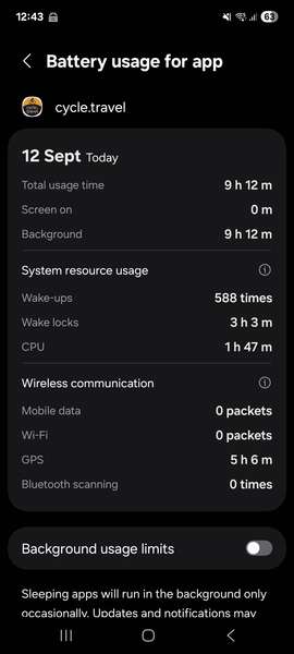

But I think dan200 has stumbled onto something that indeed exists. I'm pretty sure I exit the app all the time. Nonetheless it continues to access the gps excessively. Even when I'm sleeping and the phone is not moving (there is a way to only access a new gps position if the phone thinks it's in movement)
I started to deactivate all the background functions and restrict permissions but I'm afraid lots of folks won't be able to do so themselves and might be impacted.
Sending a screen from my batteryinfo:
For info: At no point there is the notification that routing is running.
So maybe checking if the logic stops after routing would be appreciated. Fully understand your limited time budget as you have to manager everything over 3 platforms and more.

Do you know if you have a route open (i.e. a line showing on the screen) when this happens?

I will reactivate background mode and try to monitor what's happening.
Mon 22 Sep 2025, 14:07
Hey Richard,
it's quite possible I was in the app to edit a track and then forgot to exit the track before closing the app. Everything seems fine since I look out for this.
