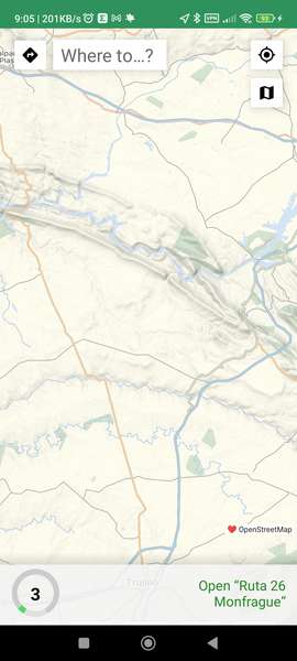

Perhaps you just need to use a finger or thumb to 'slide' the footer into view. I use android but this is my opening screen:

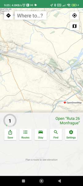

However, if I 'slide' up from the bottom ...

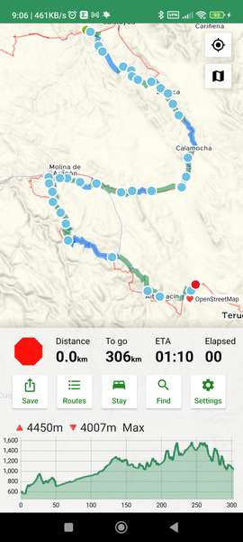

Navigating in a route I can see the elevation by doing the same

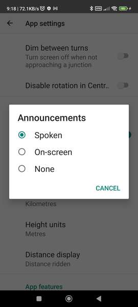

Again, I'm using android but in 'App Settings' and selecting 'Announcements' you should see something like this
