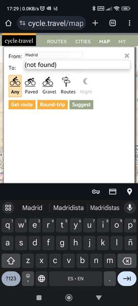

We are currently cycling across the US. When creating a route we type the name of a "real" city in the box but get a "Not Found". But it does create a route.
Thoughts?.
Thoughts?.

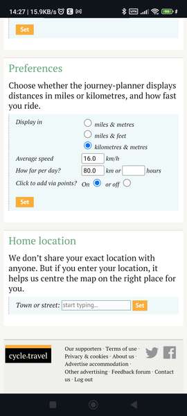

Another bit of a problem. I cannot seem to add more points at Click on map.It was working before now nothing.
There appears to be an issue with the search box everywhere at the moment. The search seems to be working as normal (although invisible). That risks the possibility that the 'default' choice may not be the destination you want (the same name can appear in several places). I suggest double checking your destination until the bug is squished.
As to your adding via points issue, have you checked under your profile that this option is active? See below
I’m not aware of any bug – are you still encountering an issue? It could just be the server having a hiccup.
Just checked and it's still happening for me (Chrome on website).
I tried waiting but nothing happens. I can add Paris to the destination box and it's the same. If I hit get route though it creates one
That’s odd – still fine for me. I’ve just restarted the server just in case.
Richard, FYI it's the same situation this morning in Chrome.
However, Firefox is working as normal.
I tried clearing the cache (my default thing to do) and no change.
That’s weird. It’s working as I’d expect on the latest Chrome (well, technically Chromium, but same thing really). Have you got any extensions installed – ad-blockers or the like – which might be preventing something from loading?
No ad blockers, but I do use a VPN. I should have said earlier that it's the same on Chrome even with the VPN disabled. Only a couple of extensions that I can't see being related and have been on since I got the Chromebook, anyways.
This is my version of Chrome: Version 125.0.6422.140 (Official Build) (64-bit)
Happy to try any suggestions you may have.

I have same issue with the search box since a few days now. I'm using Android.
Showing the facility to a friend, a couple of hours ago, he did not had any problem on his phone. Unkown which platform he was in.
I've just noticed a little quirk about this - there is a difference between being logged in and out.
Essentially, being logged in means that the search facility does not work in both Chrome & Firefox.
Logging out, the search facility works as expected in both.
Perhaps this will help you narrow down the problem.
I’ve just fixed it, I think – it was an issue if you’d created POIs without giving them a name. Let me know if that works for you now.
It is indeed! Well done & thank you!
Working now. Thanks
Yep! It works.
