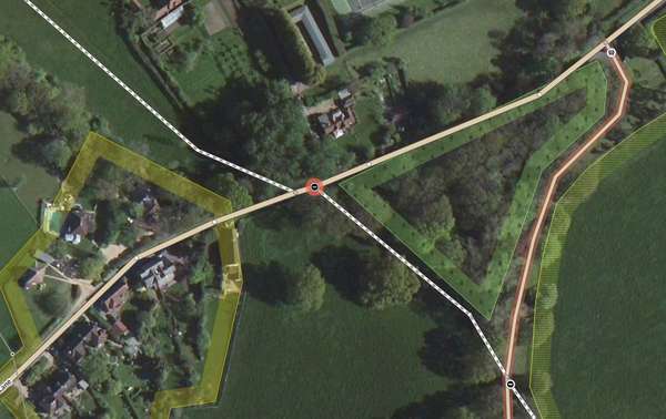

See Rowlands Castle to Stroud. I wanted to continue along the road from Cricketers inn junction but it put in this loop and I cannot drag it back
I think it is because there is a stile from where a footpath joins Ridge Common Lane and is 'sticking out' on to the road causing the problem, will need correcting on OSM.

I have corrected the stile on OSM so I assuming that is what the routing problem was. Will take a while (?) for this site to update to the OSM changes I have made before someone can test it.

While waiting for the map to update, you should be able to drag via markers to either side of the obstruction, click the earliest one and pick "Direct to ..." in the pop-up to override the map and put a straight line between the markers.

Yeah, thanks to Steve for fixing the map. I'm pretty sure some other sites do ignore them, as I've definitely been routed over stiles before which seemed to be on the map when I looked!
Yippe! fixed.
