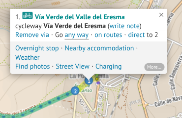

However, the idea of maintaining the integrity of an existing route while adding a section with different criteria (for example, a gravel section on an otherwise paved route, or a non 'Routes' option on a long 'Route') already exists. Unfortunately, it involves viapoints.
If you're not aware, the dialogue box that appears when we click on a VP contains many powerful features. The 'Go' feature might just become a good friend.

Fortunately, we can tell CT when (and what sections) to 'ignore' our routing preferences. That is done using the 'go' feature as highlighted above. One viapoint is necessary. One subsequent click. More info here: https://cycle.travel/help/route_planning/route_types

Try using the 'Go & Any' feature on the first viapoint.

Thanks, I understand now. So CT already caters for what  Frans seems to be after! You just need to know how to do it ...
Fri 3 Jul, 18:16
Yes. As was said in the very first reply.
