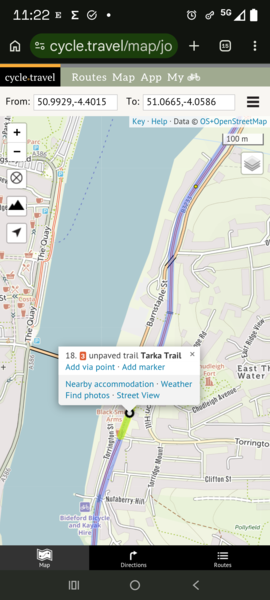

on the website, we can tap on any point of a route and see some basic info:

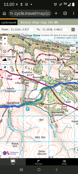

In relation to your specific request here is a CT map of part of a route

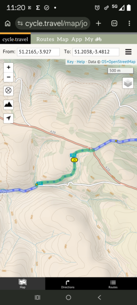

Here is the exact same route, same scale etc. but the map style is OS

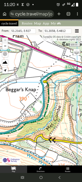

However, if I zoom in you can see that the plotted route varies slightly from the marked path/trail/road.
Perhaps this is what happened?
