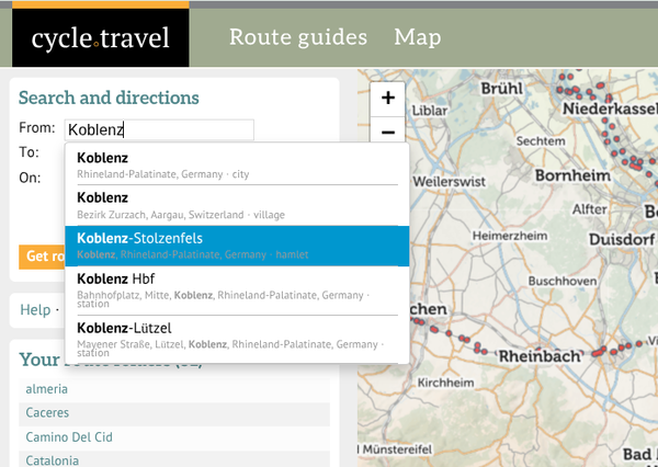

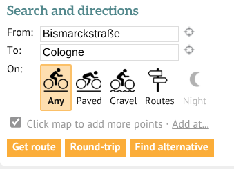

Say you wanted to cycle from Koblenz to Koln in Germany. On the map we can start to write 'Koblenz' in the 'From' box and see something like this
Simply choose the most appropriate start point.

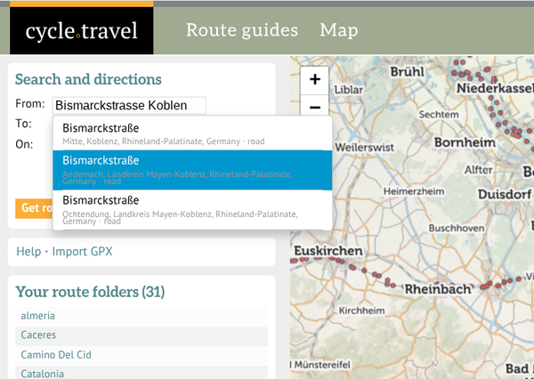

Alternatively, if you wish to start from a specific address we can try that too (taking local naming conventions into account):
Now, you've plotted your route from Koblenz (specific address) to Koln (general address).

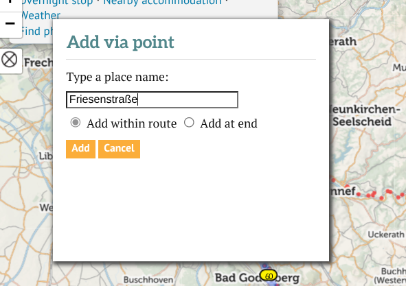

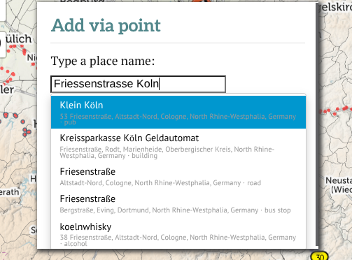

With the route open, click on 'Add via Point' under the Routing Options (Any, Paved etc.)
You'll see something like this and you can use it as we previously did - searching by name or address

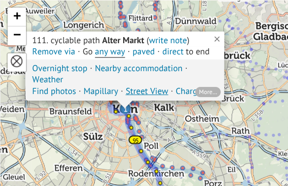

When you choose an option you'll see something like this asking if you want to add the viapoint at the end of the route or within the route

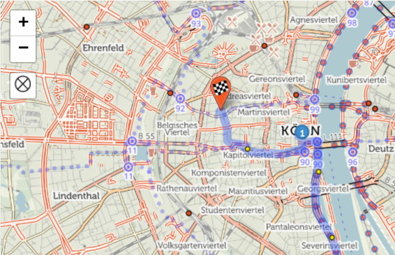

 Make your choice (End) and you'll see something like this:
 Note: CT has added a Viapoint at the original destination (original route) and added your new finish point after that

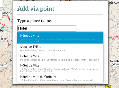

That's it. You did not give an example route and based on experience, the address search feature can be more or less effective in different places, partly due to language, naming conventions etc. Is it the 'Hotel Europa' or the 'Europa Hotel'?

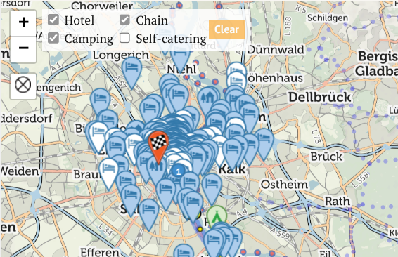

If you're not aware, CT has the ability to search for accommodation near a route. Simply right click on any route
Choose nearby accommodation to see something like this:
