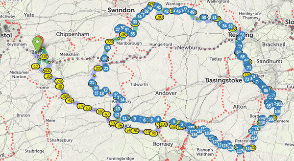

I took an existing GPX starting and ending nearly the same spot in Winchester but I cant seem to change the start and end point as its not a circular route.
I am adding a leg from Bath to join the route and want Bath to be the start and end. Can you tell me how I do that please?

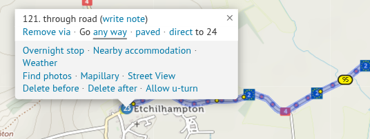

1) Working in the cycle travel website, open the Winchester to Winchester route that you have created from the GPX file; add a via point on the existing route east of Etchilhampton; then click on that via point and select the option "Start here" (you will probably need to click on "more options" to reveal that menu item). For me, the KAW route now starts and finishes at the added via point ie it has rather magically joined the break in the circular route across Winchester.

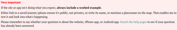

Robin, answering your question would be easier if you had followed the advice in the red box above your initial post.

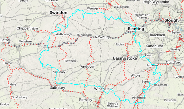

Since you haven't shared the gpx you are using I am using this one, created by a user @BradHelper and using the website, not the app.
What I would do is add a viapoint as close as possible to the start point and one as close as possible to the end point. Then, I would carefully drag the start point to Bath. (It may need to be done in stages). Once located, I'd do the same with the end point. Voila! It takes seconds.

@Simon Day I do not see the option to 'Start here' on the route I am using, possibly because it is not a circular route.
To do that, I'd download the BradHelper gpx file, start from scratch and display that gpx as a 'Trace'. Then I'd start in Bath, and plot a route to the most practical place to join the 'Trace'. Using the 'Trace' I'd create a route along the KAW and back to home. (Trace is available under the 'Hamburger' menu, top right of the map screen)

The first of the user-created routes is Reading to Reading, by Any surface. Note like Robin's GPX-source route, it is not a true circular, in that the start any finish are on north and south side of Reading railway station. When I click on any via point in that route (an existing point or an added one) the "start here" menu option exists and behaves in the manner I described.
I have replicated this by creating my own near clone version of Reading (north side) to Reading (south side) via a rough version of KAW; the "start here" option is available and behaves as above. (Saved just now as a public route named "Test for start here" https://cycle.travel/map/journey/914187)
The odd thing is that the "start here" option does not always appear in routes ...eg the 6th user-created route returned by my search for KAW is a version from Winchester to a slightly different point in Winchester; so seemingly conceptually like the Reading example and my test, but the "start here option does not come up. Seems one where we need Richard's guidance on what is happening?
From further experimenting: it seems the "start here" menu option always appears when the start and finish of a "horseshoe" route are within a few hundred metres of each other - seemingly up to approx 200m apart; otherwise it is not offered. It does not appear to be affected by the length of the route (I had wondered if it might be proportional to the route length, but seemingly not).
So it does offer a universal way of editing "very nearly cicular" routes to make them start/finish at a different point on the route; and converts them into true circulars as well.

Hello Simon. Your fix of moving the Start and End closer together worked!
Doing 'Add via point' east of Elchilhampton and then moving the Start and End points to Bath (Dundas Aqueduct) I now have the route I want!
