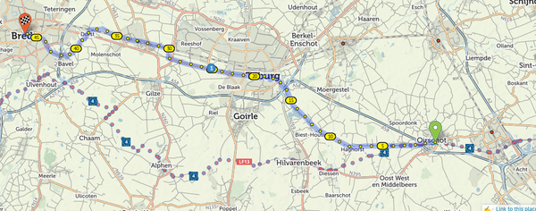

Here's an example from my dim and distant past

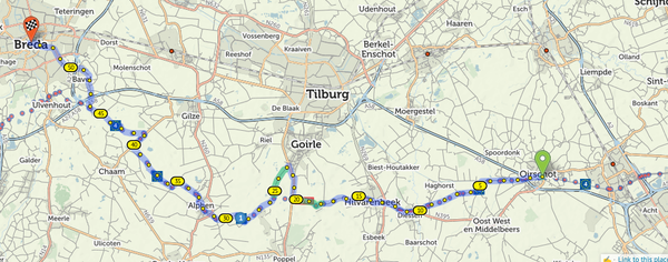

I add a viapoint (as above) and drag it away from the city as below....
The second option is about 5km (10%) longer. In other parts of the world it may mean more climbing too.

Routing options are very hard to do with the way the route-planner works, I’m afraid. c.t does apply a small routing penalty for big cities, but it also likes traffic-free cycleways and cities in the Netherlands have lots of those…
I would say, though, that the ‘Find alternatives’ button is very definitely your friend here. If I plan a route from Breda to Oirschot, although the default suggestion goes through Tilburg, clicking ‘Find alternatives’ finds three other routes that avoid it. Hopefully at least one of them goes past a bakery!

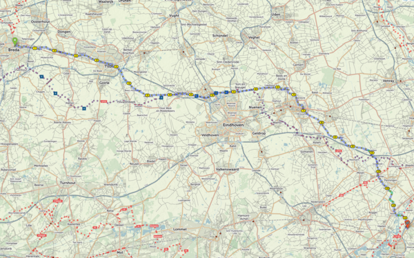

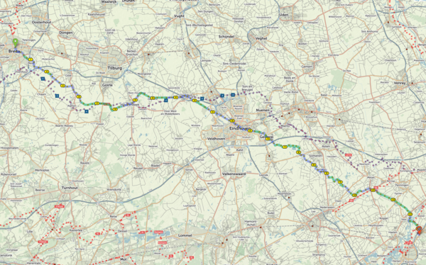

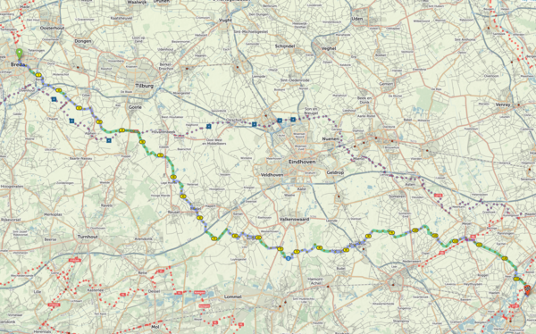

Some examples.
Imagine drawing a straight line, the route would end up south of Eindhoven (shortest).
1st image: How it should be (Gravel, manually added via point)
2nd Image: Gravel automatic planning, straight through Eindhoven.
3rd Image: Any automatic planning. Straight through Tilburg and other urban areas. Notice the empty space around the urban areas.
It must be said when changing the route manually a better result is achieved really quickly.

It's good that you finally shared an example of what you are experiencing. Unfortunately, I cannot make out the detail in your images but I think you're looking at a gravel route between Breda & Roermond?
On gravel: it avoids Eindhoven, automatically.
On any it also avoids Eindhoven automatically
Even on Paved it does a very good job of avoiding the big places.

The route shown in the images is from Breda train station to Swalmen.
For anyone who wants to have a detailed look.
