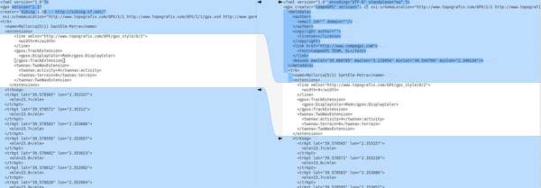

A friend send to me a GPX file. Trying to import it on cycle.travel, I get “No GPX track was found in that file. Please ensure it contains trackpoints.” I just open and export it with Viking and then file was right imported.
I can email you both files if you want, but here is a diff from the heading.

I think I’ve identified what the problem is – should be fixed now. Thanks for spotting.
(For those of a technical bent, the BOM at the start of the GPX file was confusing it!)

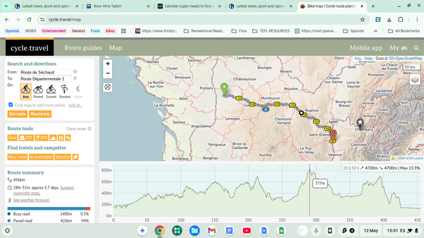

HH, if you're not aware there is a 'workaround' for minimising climbing currently.
Obviously it depends on the length of your route, but by opening the gradient profile, adding a via point and then 'dragging' that viapoint around you can see the effect of different options 'live'.
In fact, we can pinpoint the highest/steepest climb (the red line on the graph above), add a viapoint there and then move that one around to find an elevation profile that suits.
We just need to be careful where we 'drop' that viapoint.
Also, if you're not aware, CT offers the option of an 'alternative' route. (under the different surface options there's 'Find Alternative'). That can help too.
