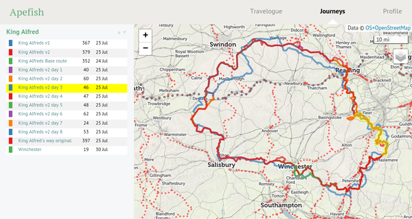

Thanks for the response, “Also, if you're not aware, you can display all your routes in a folder on the one map - a handy way to make sure that every leg is connected.’ This is a great tip!

Ooh, viewing all routes in a folder is a game changer for me 😁 now, excellent work all round. I played around with a C2C route across the Pyrenees (doing it in Sept) and thought I'd check for tips in the forum.
I probably did my route a bit back to front and now have separate routes for each day. I started with an end to end route, forcing it over lots of cols using via points. I saved a new copy and deleted route before and after that days start/end points.
