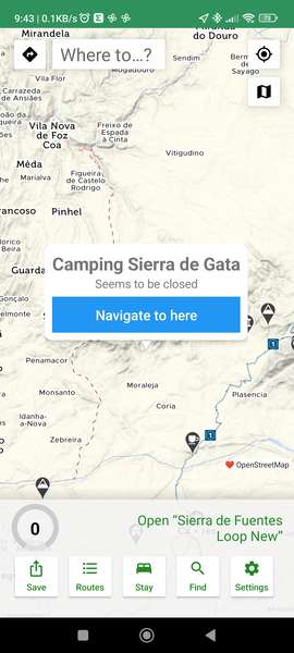

I use Android and I can see that some of my markers are not displaying in the app. It seems that these are the ones labelled as 'Public'. The Private ones seem to display as expected (I have a lot of markers!) IOS may be different as the updating process is different for both versions.
However, these do not seem to be editable - I can only use them to navigate to, from or via although the text box does show what I have in the text field of the marker.
