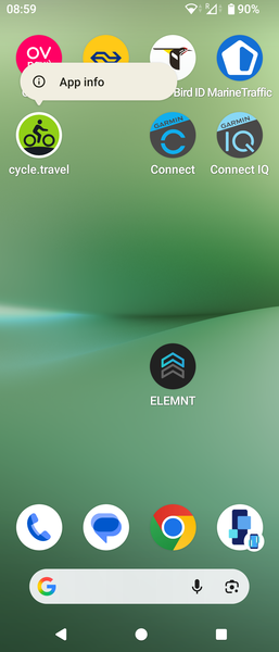

Apologies if you have already solved this, but long press (press and hold) the Cycle.Travel icon, then an app info bubble pops up:

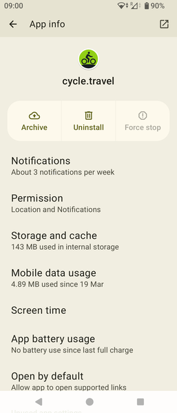

Tap that bubble and the app status appears, including permissions:

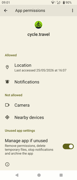

Tap Permissions and further status will appear:
Note that Notifications must be allowed. Permissions can be withdrawn if you don't use the app for a while.
