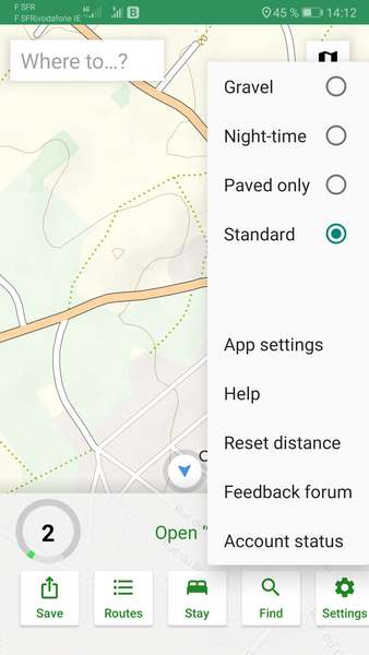

• However for the ‘Offline Maps’ after un-installing/re-installing: Going into ‘Settings Menu’ my immediate reaction was that nothing had changed I could see no ‘Offline Maps’ icon. However you mentioned in your reply that the icon ‘Offline maps’ was 6th from the bottom so I clicked on the space (above the ‘App settings’ icon) where the icon should be & ‘mon Dieu’ it worked I can see the tiles of the map. I clicked on a blank space above that again & it clears the map. So icons ‘Offline Maps’ & ‘Clear Map’ are there but are not labelled it’s just blank spaces, quite strange! So now we are not sure whether they were there all the time & not labelled or the uninstalling/installing did the trick? So when I click on the offline maps blank space it always takes me to the UK tile map so I’ve got to each time, bring the map to my location here in France. Since the CT tool is geo-localised to my position, should the offline map home-into my present position? would make life easy non? But I suppose the main thing is I can now use the Offline Maps (the invisible icon!).
Thanks a lot for your helpful advice, much appreciated……J.
That is really weird! So does the pop-up menu when you click the settings icon have no text in it at all?
Hi Richard, When I click the 'Settings' this is what I see. See screen shot enclosed.
That’s the strangest thing. Thank you. I’ll see if I can find out why…
