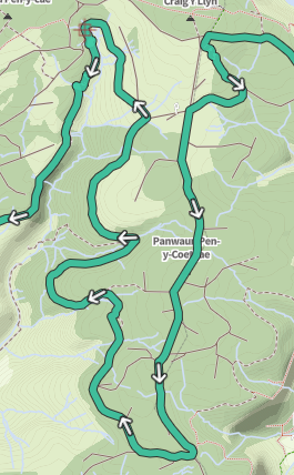

https://cycle.travel/map/journey/476559
I got the trace of Skyline on the map, result. But if I try to drag the route onto it, or click on it, it doesn't follow the blue line. Can I get it to do that? Is there a manual plotting function I can't find?

It's not clear to me from that route what it is you're attempting to do. All the Skyline or part of it?
Add and use the viapoints to go where you want to go.
Personally, I prefer to add viapoints from the end, not the start.
On a twisty, turny, loop like the Skyline placement of viapoints is vital. One in the wrong place will throw the route into chaos.
It may help to focus on just one section then, when happy, move onto the next.
So, for example, if I wanted to include *all* the Skyline as part of a longer route I'd start with a blank map, add the Trace gpx, add in the start and end points (start and end of Trace), then working backwards add a viapoint where the CT route was different to the Trace, drag that onto the Trace and repeat.
Once I was happy with that, I'd save it, then start adding in the before & after sections, perhaps with a different name so that I always had the Skyline section "safe".
If you're not used to doing this, I'd heartily recommend practising on a simpler example to get used to the process. Pick any decent stretch of "bike route", add start and end points then practice getting the CT route to match the official one.

Thanks, I have done as you suggest (https://cycle.travel/map/journey/476741) and can make the route follow SOME of the trace (waymark 3 to the end) but not between waymarks 1 and 3. I realise now you can't see the trace, but I need to head south in a big oakleaf for 15k or so starting at point 1 and rejoining at point 3. I cannot get the route to follow that part at all.

I think it’s probably because the paths are either missing in OSM or not marked as allowing bikes. As a general rule, if there’s nothing showing on the default c.t map, you can’t route that way; if there’s a faint green dotted line, you probably can’t (though c.t will sometimes let you drag a route onto a green dotted footpath with an attendant warning about having to push your bike).
In particular, in the UK, if something is purely marked as a “track” in OSM with no indication of bike access, c.t won’t let you route along it.

Your use of "waymark" is throwing me. If referring to viapoints 1 & 3 the Trace gpx file is nowhere near there - or at least the RWGPS trace that I am using.
I can see that some of the Skyline route won't plot at all on CT (I originally looked closer to the town starting with G) but you can see in the example below how I would work around that by using the part that does work, (viapoint 7), using the "direct to" feature (to viapoint 8) and writing a note to myself (viapoint 7) to not loop back the way I came.
https://cycle.travel/map/journey/477146cycle.travel/map/journey/477146
The risk is that there may be different trails up there not showing on any maps that may be confusing in real time. Your Garmin will beep all the time you're not on the "straight line" but should pick up the route again at viapoint 9.
It's not perfect, but It does allow you to have one whole route.
Of course, it all depends on the accuracy of the gpx Trace that you are using. There is no guarantee for that!
It's worth remembering that what you are looking to do is right on the limit of what CT does - in fact, there's an argument to be made that CT is not the best planner for this type of riding - and that other options may be better. I'm thinking RWGPS and (perish the thought, Komoot).

OK, thanks Richard and Hobbes. That part of the mtb trail is relatively newly opened after they built a wind farm, so it's simply not on the map. I have previously used Bikehike which allows me to plot a route anywhere at all by clicking on every turn, and I was trying to do the same here. I will try uploading the gpx from CT to Bikehike later and see if I can add in Skyline there. (Sorry, with waymark I meant viapoint! I'm an amateur!)

The southbound bit isn't right (should be further east), but the northbound bit is. I actually rode the route yesterday... and missed a sign on the northbound bit but no drama. Also missed a couple of turns elsewhere and had to wade through a river, but on a sunny day it all adds to the fun :-)
Fri 18 Aug 2023, 16:31
It still didn't work as the eastern part of the loop isn't on the underlying map.
I think turning off rerouting on the Garmin is my best bet.
