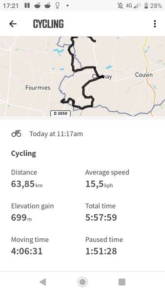

I've noticed high discepencies between the elevation gain shown on cycle.travel and the one recorded by my wahoo roam. for example in this trip https://cycle.travel/map/journey/217164 CT gives me 410m gain. while my wahoo gave me 699m gain. and I'm inclined to believe to later judging by the states of my legs :)

I’ve had a bit of a fiddle with this and the good news (!) is that I’ve uncovered an issue with elevation on railway paths. I’ve fixed this now and done a little extra tweaking.
cycle.travel now shows 540m elevation for this route. This looks broadly right to me. I’m having difficulty seeing where the Wahoo gets its 699m from – it’s possible cycle.travel is still slightly understating the gain but not by 160m, I think. Even RideWithGPS (which tends to overstate total climb) is only showing 584m.
Thanks a lot, I don't mind a little under estimate. I'll report back here next time I ride on a railway path.
my first guess was that it was simply a side effect of a difference in resolution of the elevation data on the map and the sampling from the Wahoo. Maybe lots of little half meter ups & downs recorded yet not present on the resolution of a country-wide survey. something similar to the Coastline Paradox : https://en.wikipedia.org/wiki/Coastline_paradox
