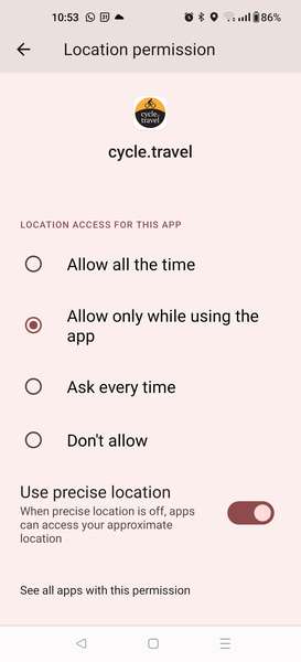

Some more information on my use case, I have granted location permissions "only while the app is running", like so (iirc, until this update, "all the time" wasn't even an option):

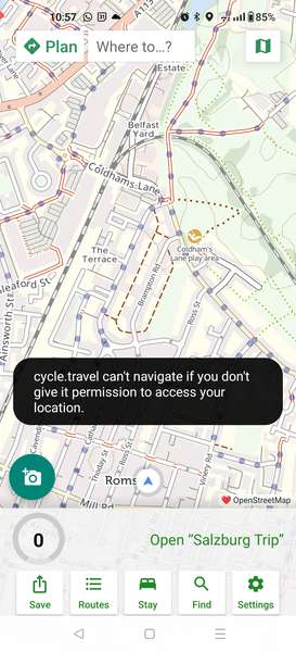

Whenever I open the app, I get these screens:

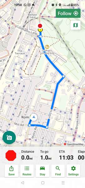

The text in the latter popup is misleading, because after I dismiss it I'm able to then "navigate" just fine, it just won't give directions when the app is minimized, which is exactly the behaviour that I want:

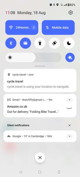

Update: I also still get this un-dissmissable lock screen notification whenever the app is running, even with the "only while using the app" setting selected. I had forgotten about this because I muted all C.T notifications after the first few times it happened.
