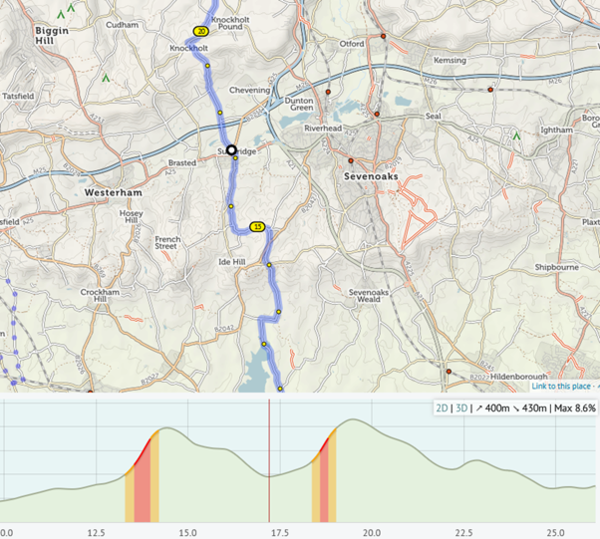

I've noticed something too that I think might be related, to do with gradients. These appear to have reduced a lot in a number of my saved rides. The example attached has two climbs that now show a maximum gradient of around 8% when they used to show nearly double that. I think the previous values are much closer to being correct than the latest ones as the gradients on these climbs definitely get well into double digits.
I might be wrong but was that screenshot taken a couple of days ago? If so then try again now – I’ve made a few further adjustments.
The screenshot was from Saturday but it looks like the issue I'm having is to do with the saved ride. I tried again and if I input the route from scratch the maximum gradients come out at nearly double those on the screenshot, so it's looking good - it's only if I reload the saved ride I get the same result as above.
