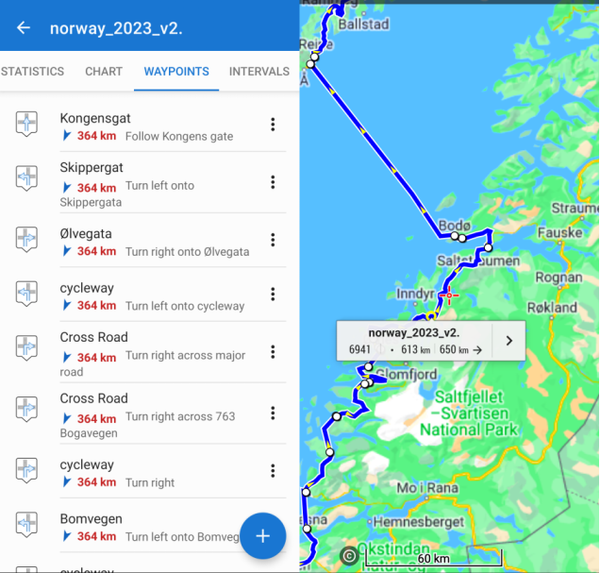

There are two version of TCX export in CT ("course" or "activity") and I forgot which one I used, but at least one of them gives me a list of waypoints like your picture above.  Yes!!  Now I just need to try this out "live" on a local route.  Are you able to get voice prompts with the screen off?  Even morse code would be fine with me.

Tried out a route imported from a TCX course and it seems to work well, thanks.  The main annoyance (which is not a big deal) is that there are a lot of points in the file marked with the "Generic" point type when a "Straight" type might be more appropriate.  These are usually route instructions like "Continue on..." when a street changes names, or something like that.  In Locus they show up as red flags on the route.  I used a text editor to change some of them to Straight types to fix this.
