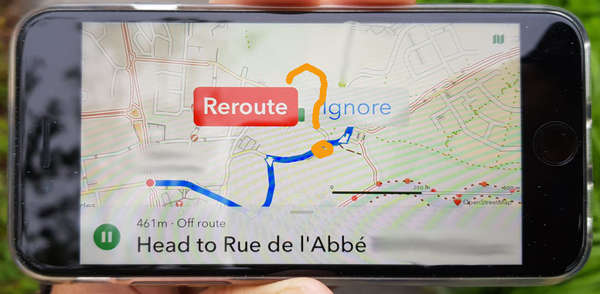

1) The "reroute/ignore" popup is masking the map. When it's cold & raining, stopping / removing gloves / dismissing the popup / putting gloves / restarting is really no fun. In landscape, just putting the "reroute" button in the lower right of the screen, just after the street name, would be fine. If it's a small obstruction, the user can see the map and turn at a nearby street to get back on track (in essence, that's implicit ignore). If really a reroute is needed, the button is still there in the corner. This is the biggest issue I had.

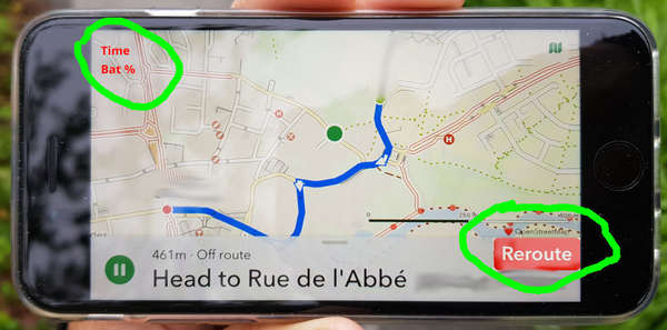

To illustrate my suggestions, this is the current situation:
And my proposal:

That’s a really helpful set of suggestions – thank you! Unfortunately losing the time/battery display in landscape is an iOS thing and hasn’t been something that can be disabled since iOS 8 or so – I’m not quite sure why Apple made that choice.
Putting the ‘Reroute’ button there on the landscape display is an interesting idea – I hadn’t thought of that and, yes, there’s plenty of spare space in landscape mode. I’ll have a play around with some layout options.
